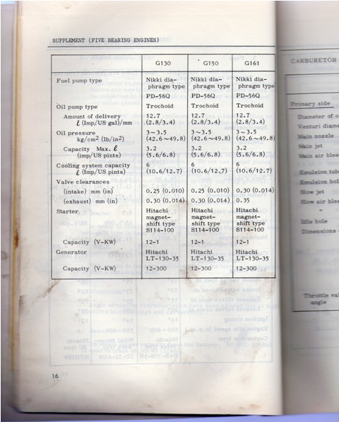

Some info from Manual

Hmmm, interesting - I've always set my G150 sedan gaps at intake=10 thou & exhaust=12 thou - it's just whats stuck in my head. I didn't know whether GT's or Florians were any different.
So I've had a look.
I think somethings been lost in the translation (metric to imperial).
Looking above it states 10 & 14 thou for G150 and 14 & ? thou for G161.
BUT the metric is 0.25mm & 0.30mm for G150 and 0.30 & 0.35 for G161.
NOW, looking at my twin-marked feeler gauge,
0.25mm = 10 thou
0.30mm = 12 thou
0.35mm = 14 thou
SO, use the metric markings, that's what would have been intended.
Interestingly, Florian's are (workshop manual) 0.20mm & 0.30mm. (8 & 12 thou). Difference possibly due to alloy head?
Begs the question, what are alloy Bellett head values? (I suggest the values shown above are for Iron heads.)
Sorry, - clear as mud??
