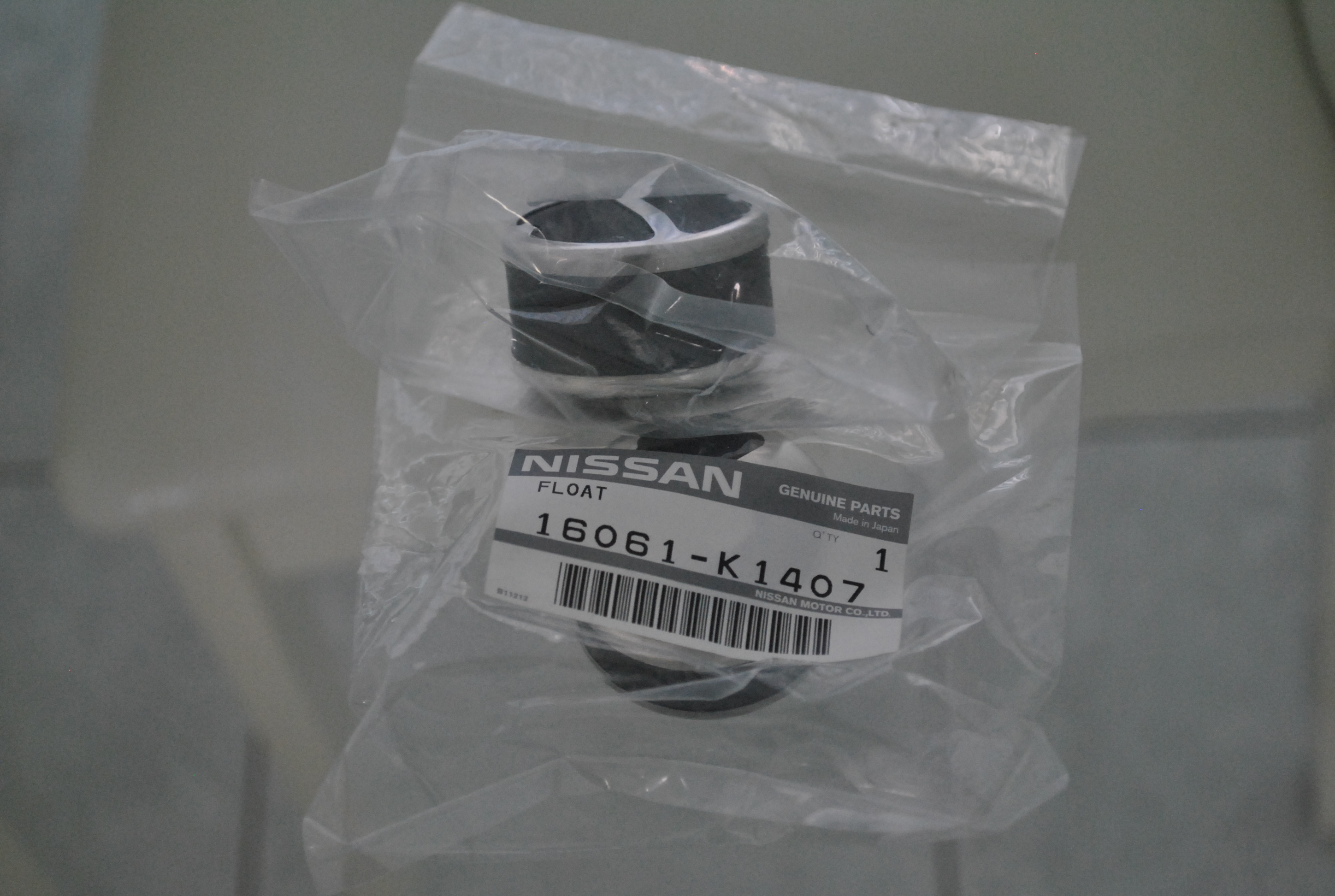

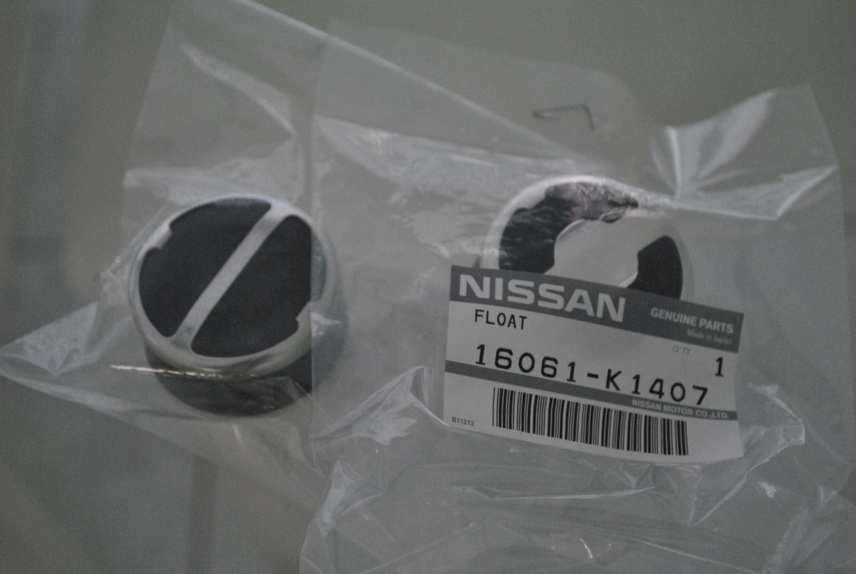

I have part no,s for replacement floats for original GT carbys.They are available through nissan parts X melbourne part no. 16061-k1407. They are a direct replacement for the old brass ones,most of witch are cracked and leak,almost impossible to repair permanetly.We have used them in our GT for the last six years.about 12,000 mls.We have used 95 octane with flashlube addative all this time with no problems usually caltex or wolworths.but some pinging on BP.Hope this some help. LINDSAY.
Tue Feb 04, 2014 10:43 am
For those of you that would be interested, I have just purchased the new floats here in Mudgee, for the pair I paid $101-10 including GST. (I was told that was trade here in Mudgee). ;)
You may do better with the price, my main point is, as per Lindsay's comment, available right now ex stock Melbourne!
If these are the only comparable part, I think they are the only ones available, good to have some spares while they are in stock!! :D
Thank you again Lindsay.
Wed Feb 05, 2014 1:23 am
This is what the Nissan floats look like, they arrived in Mudgee today 8-) .
Should I ever need them now, I will not be off the road. :)

Hi Dave, I have not seen them but I have my car in for a check over and tune. The floats were leaking fuel also but the shop has sourced SU floats from Sydney to replace them.
I have no idea on the cost or if they are E10 'proof' though.

Well, hopefully these are E fuel compatible!!
You could ask to see the originals to see what they look like?
When you had the carbies on my GT recoed, did they look similar to the Nissan ones?
Fri Feb 07, 2014 5:43 am
I don't recall really Dave but i think they were brass........ too long ago !

The nissan floats are hitachi supplied same as bellett.,and have worked perfectly in our GT since it was put on the road.I have no doubt ,they are the modern replacement for the original ones.LINDSAY.
Fri Feb 07, 2014 10:13 am
The ones in the Sport are brass as i guess all Belletts are. I unsoldered the sealing hole in top and removed all the fuel from them. I am then going to re solder (by sweating) the two halves together and i reckon they will be ok again. As spares for now.

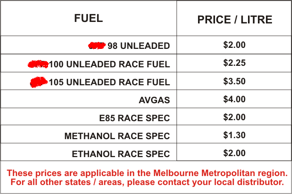

Hi Brett, that maybe, but the upshot is that most us just have to use 98 as it's more easily available, generally. Or at least the hopefully better 98's. And anything over 98 is probably wasted anyway in our cars.
The cost per litre is a bit offputting also ! (name of fuel has been obliterated) A drum deposit is also required.

Thats the price given on their web site though. What do you pay?
It's academic anyway. IMO there are simply not enough outlets to use this fuel on a regular or convenient basis. For dedicated racers etc, different story.
It also appears the fuels contain ethanol anyway, which was the whole point of this thread:- extract below.
http://www.cheetahracefuels.com.au/fuelfacts.html
Cheetah Racing Fuel burns cleaner
105 Octane rating or 100 Octane alternaltive
Contains Ethanol
Is more affordable than AVGAS
Change from AV Gas to JFP Premium 105 is cheaper for the Teams to implement -
