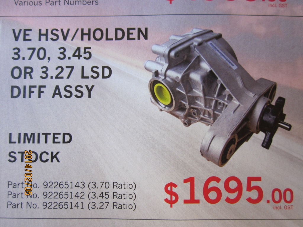

Diff centre LSD
I have no idea if there's anyway this would fit, but could be a way to get various ratios and LSD too.
I suspect it's too high and maybe too wide also. One would need the axles also, to be adapted to Bellett at the uni joint. Making mount brackets would be interesting also.
Not exactly cheap in our world but since its brand new, good value.

Would be an interesting conversion, ask Tom Amos??
I doubt it would be possible, you would need the outer dimensions of those diffs first I would think? ;)
Some VERY INTERESTING engineering would be required I would think!! :shock:

Hi Dave
I guess nothings impossible, given enough $$$$$$$$$$$$$$'s ;)

Would the diff centre's fit the Bellett outer :roll: I doubt it, or if anyone has tried the experiment :roll:
LSD good idea though!! 8-)
