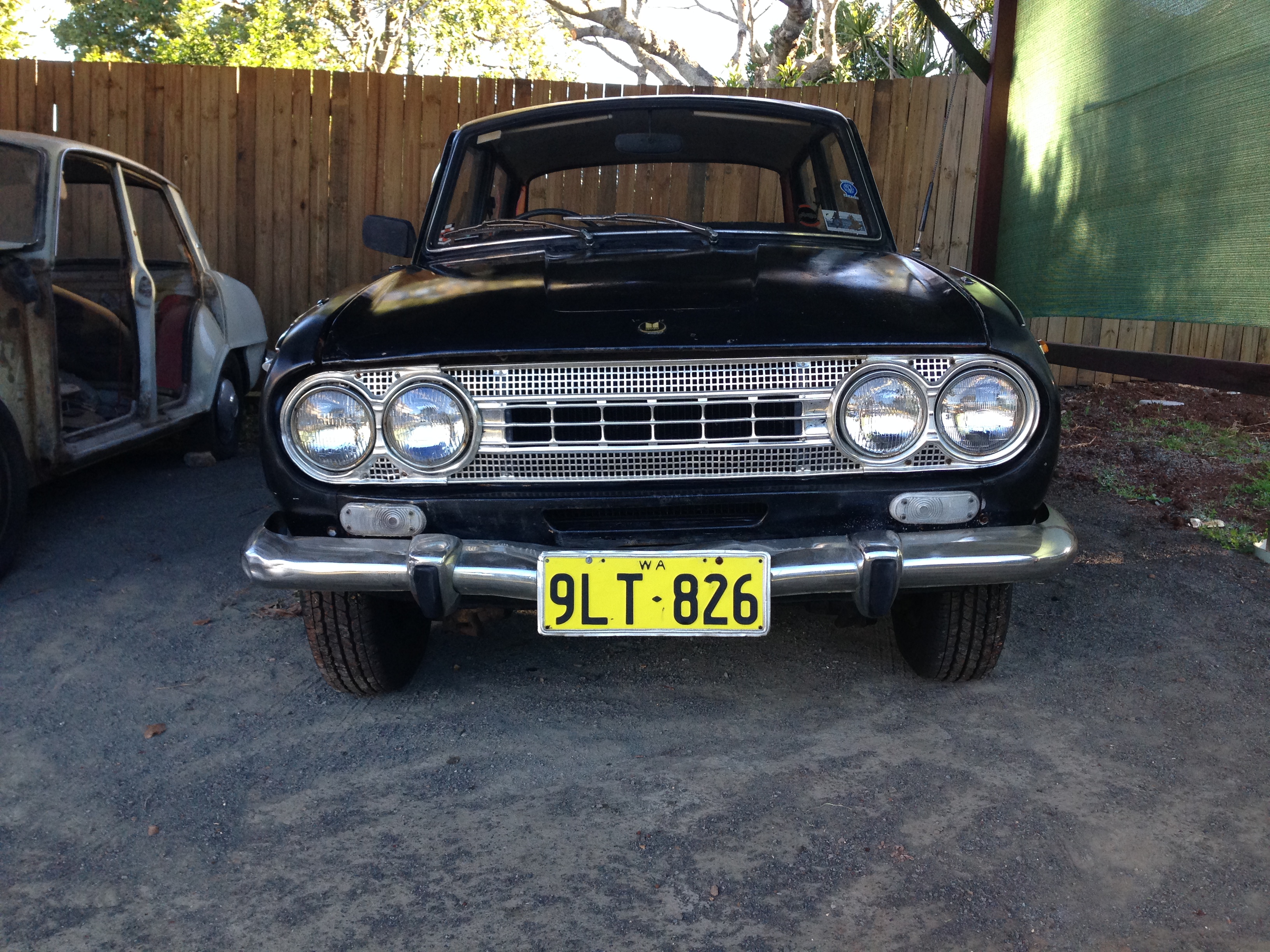

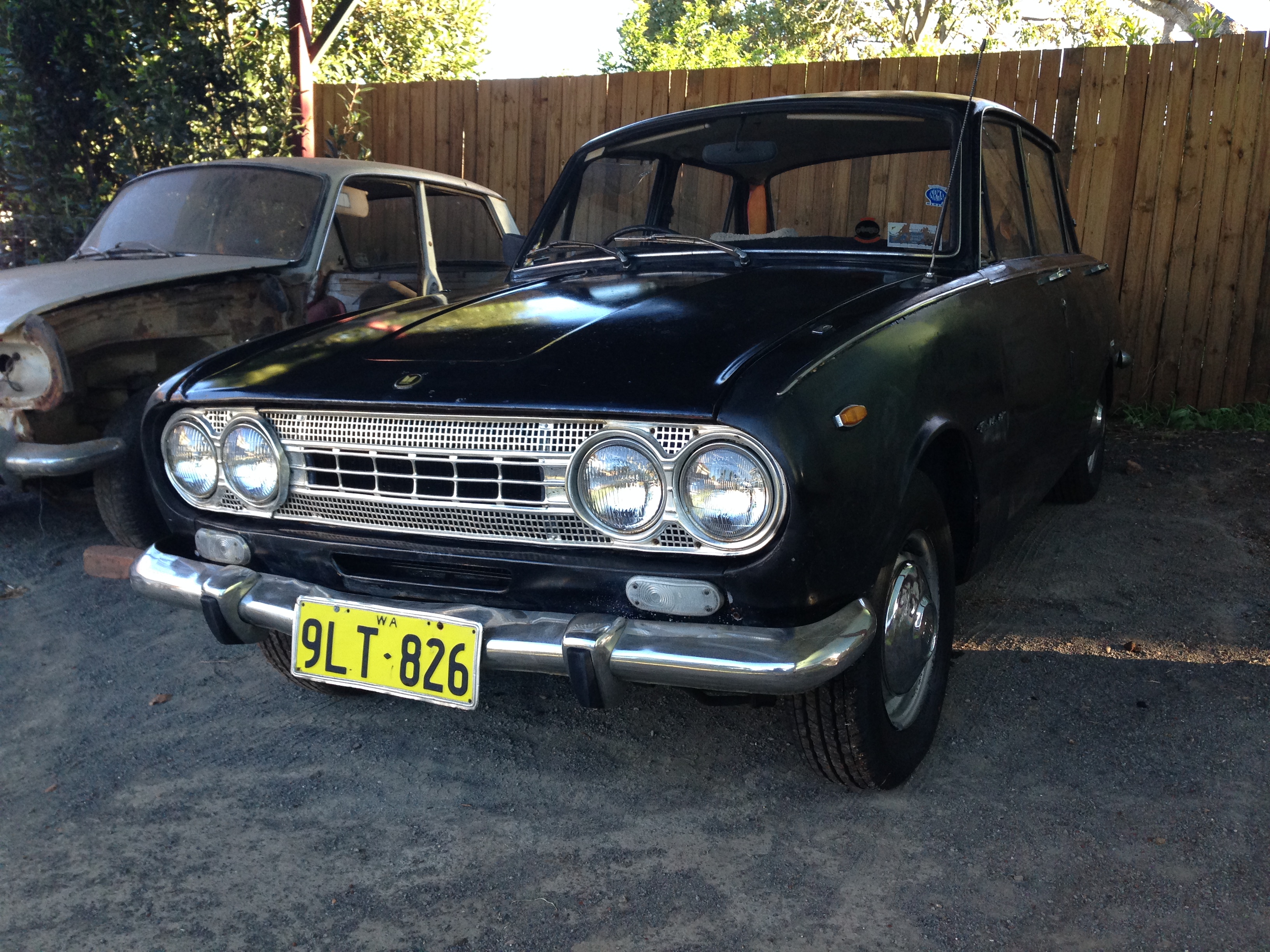

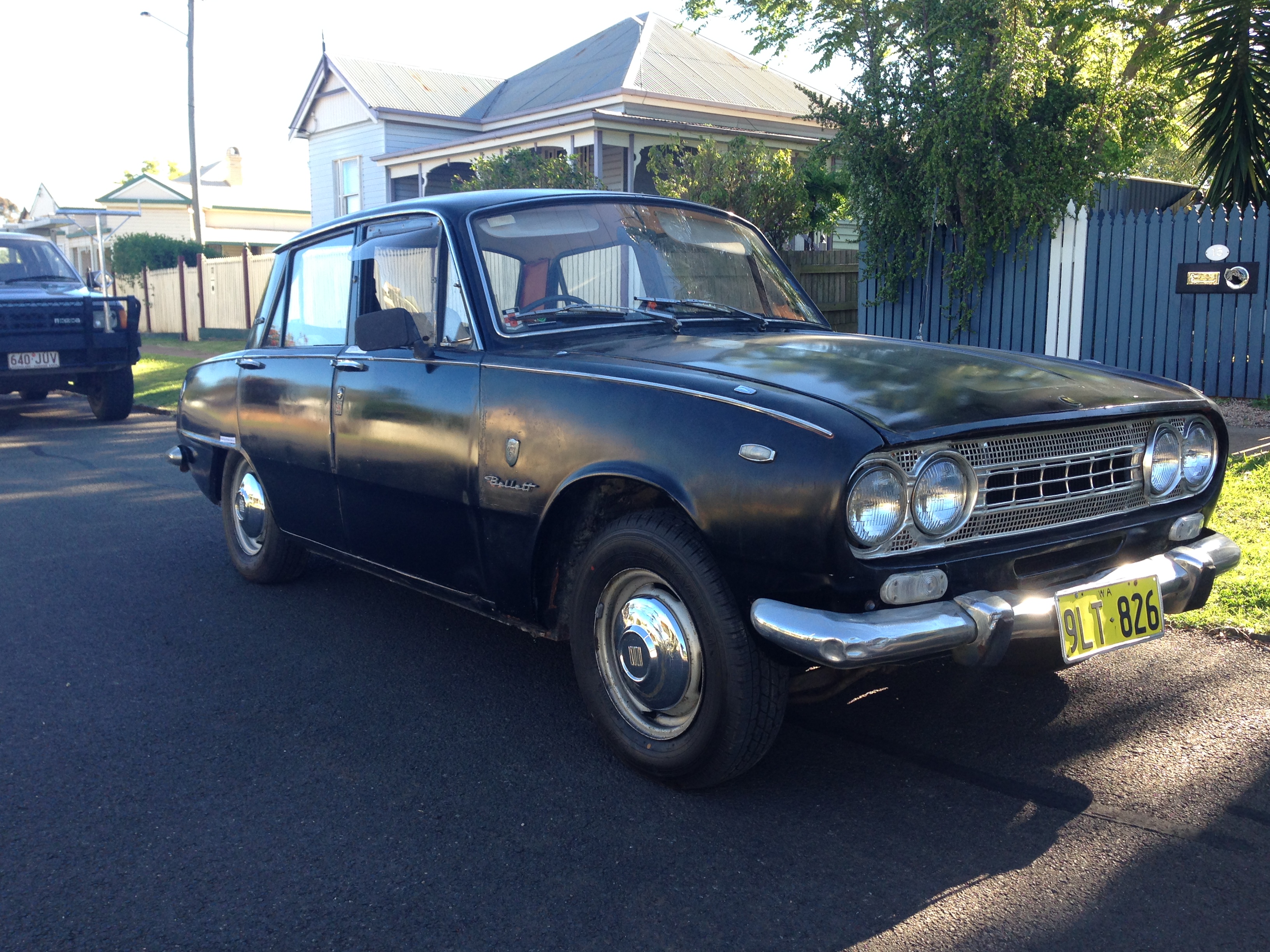

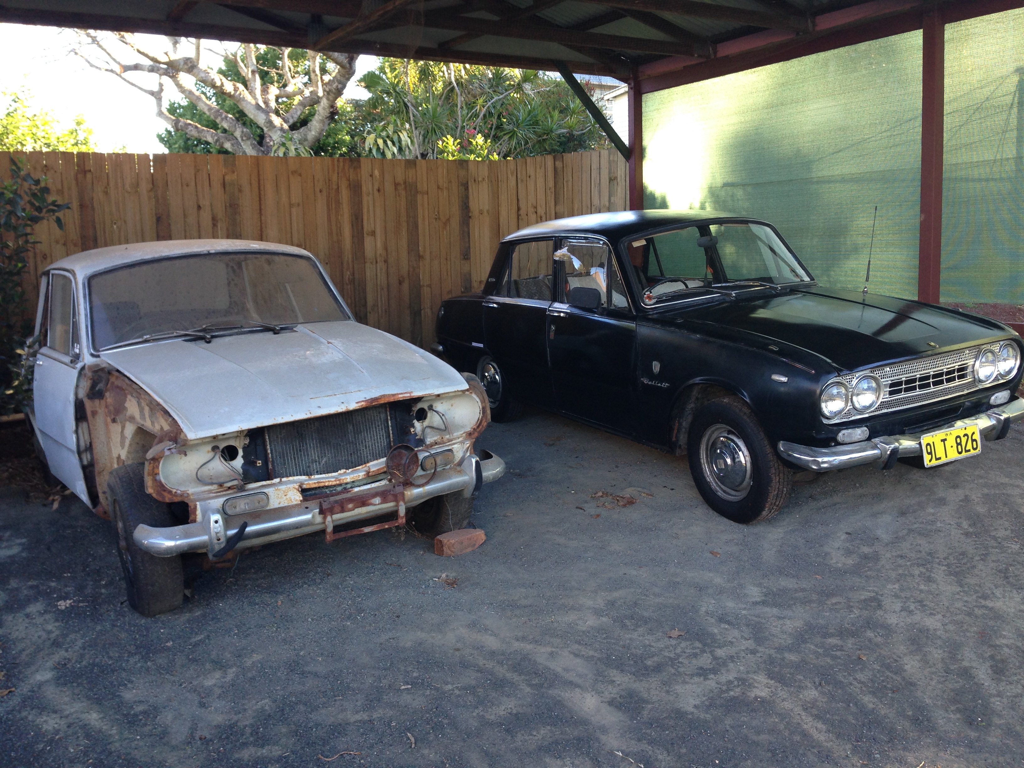

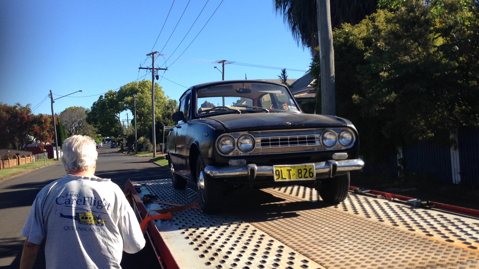

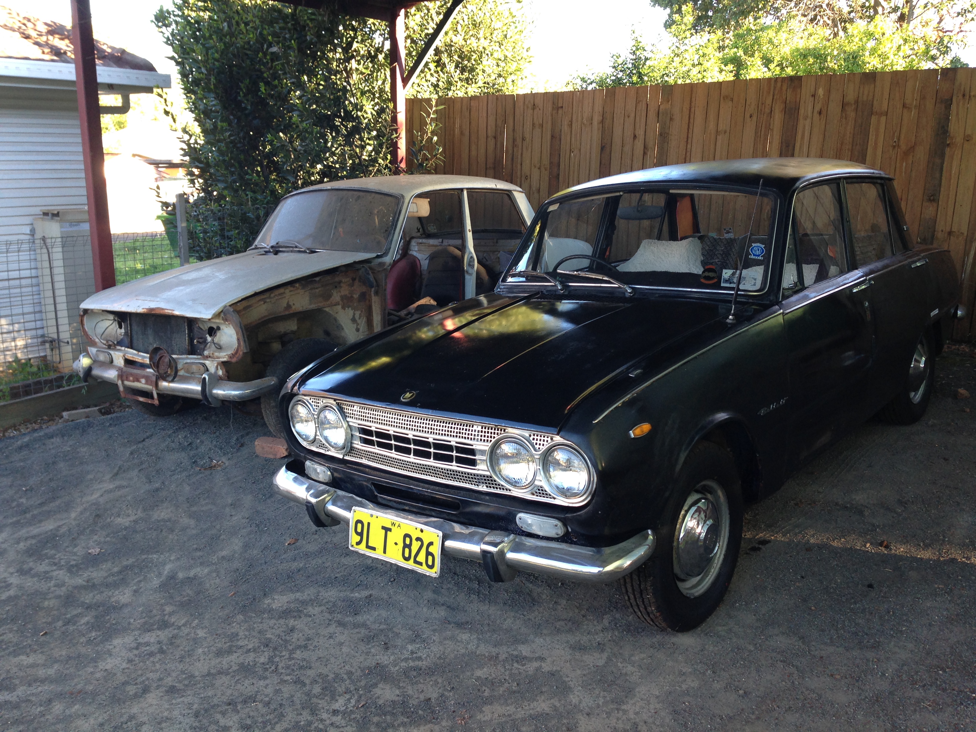

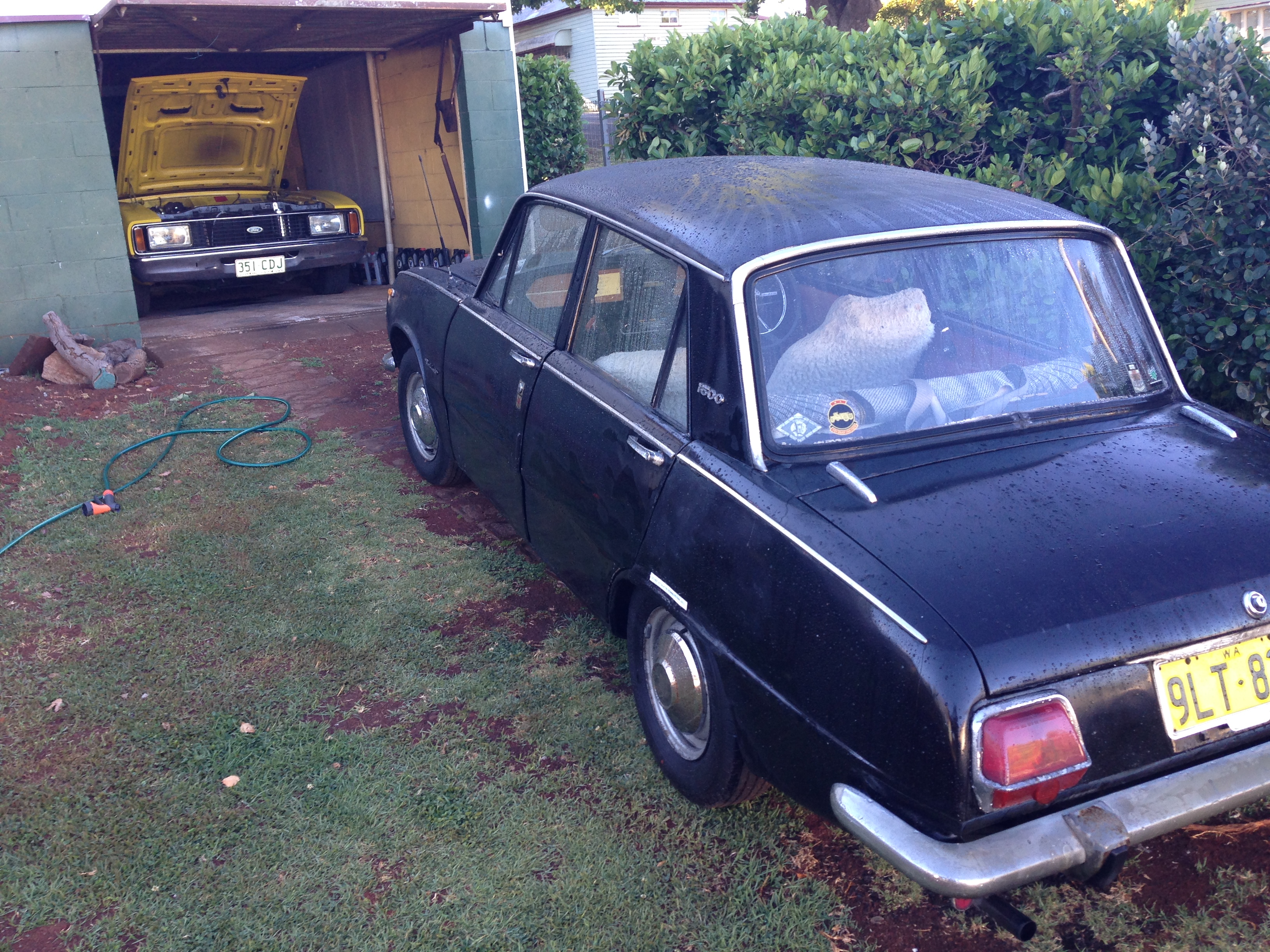

Sorry Gunna, couldn't help myself, someone from Toowoomba did get quotes, it arrived today and it now resides in my carport, some TLC is required, but it is a running vehicle and very presentable, some photos attached.
It's my son Michael's birthday tomorrow (19th), so it has arrived at a very appreciated time.
My apologies, looks like I got the photos out of order.

Ted Freeman
Tue Oct 18, 2016 8:39 am
Excellent!!!
Tue Oct 18, 2016 8:55 am
FANTASTIC!
What a great idea! Now you will have one each!
That is a really good thing to do for him Ted, good on you. And it is a nice looking car. Factory black is very rare too.
Can't wait to see you guys cruising it.
Cheers, Matt. :D :D
Tue Oct 18, 2016 12:10 pm
This is GREAT NEWS, another saved. Well done Ted, would be GREAT if we can see it at next years National meet in Mudgee NSW, 13th to 16th October 2017. Details under Events, Bellett National 2017, on this forum.

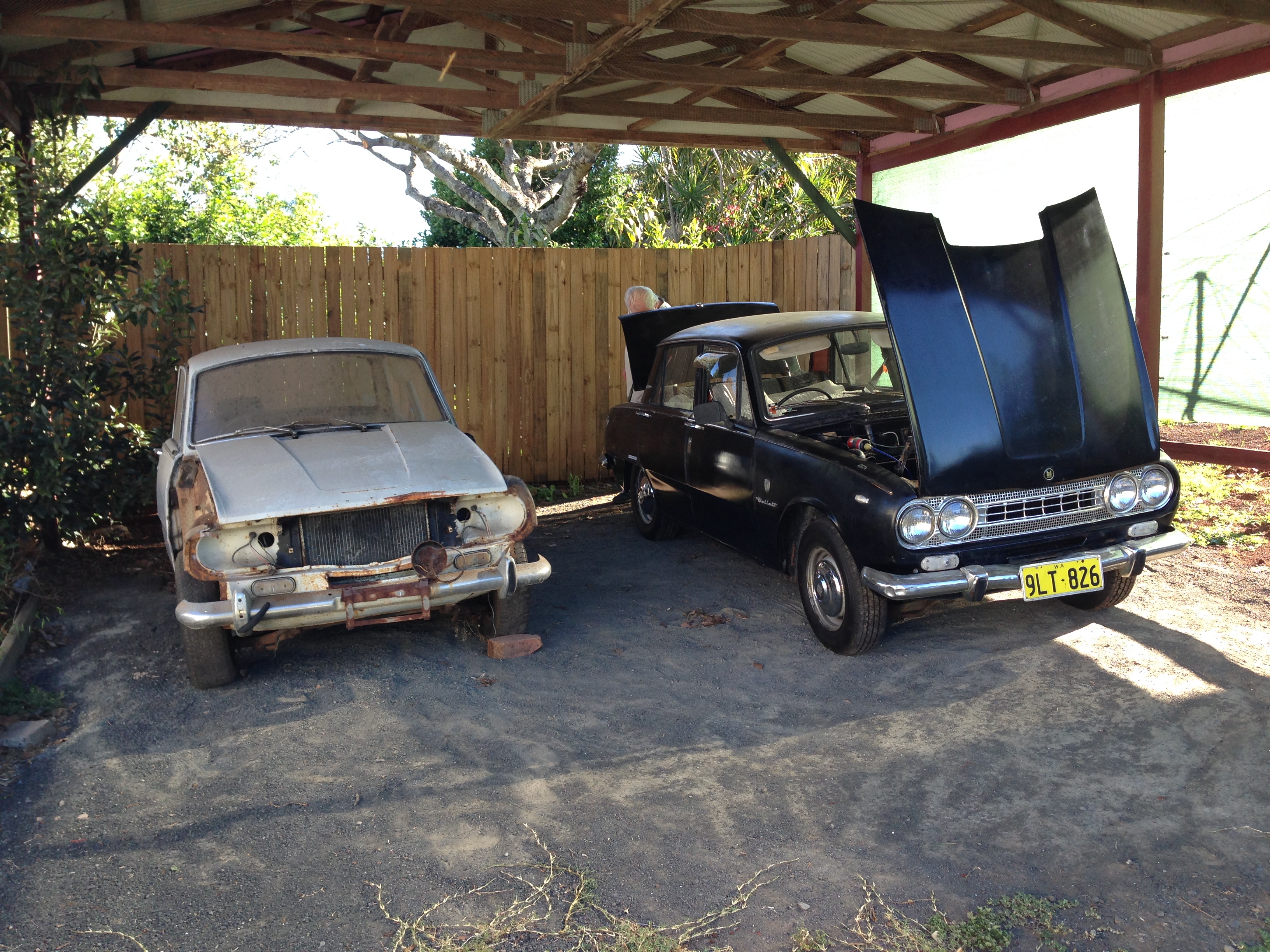

First is 66 model. (Last of the teardrops.) This is Doris, so is an original auto with 3 bearing. (Rare model) They are same spec as 66 1/2, with alloy tappet cover with push in cap, late long point dizzy, small black separator box with breather pipe on the passenger side, and low starter motor. And rubber mounted steering rack.
Next is 67, with 5 bearing, alloy cover with spin in cap and separator that vents into the air cleaner.
Next is 68. They went back to push in oil cap, and the separator vents to the open, via a hose aimed at the road.
(This is an auto....and I didn't do the yellow!)
Just for interest, here is a 66 1/2 auto. It scored the 5 bearing, while the manuals had 3 bearings!
