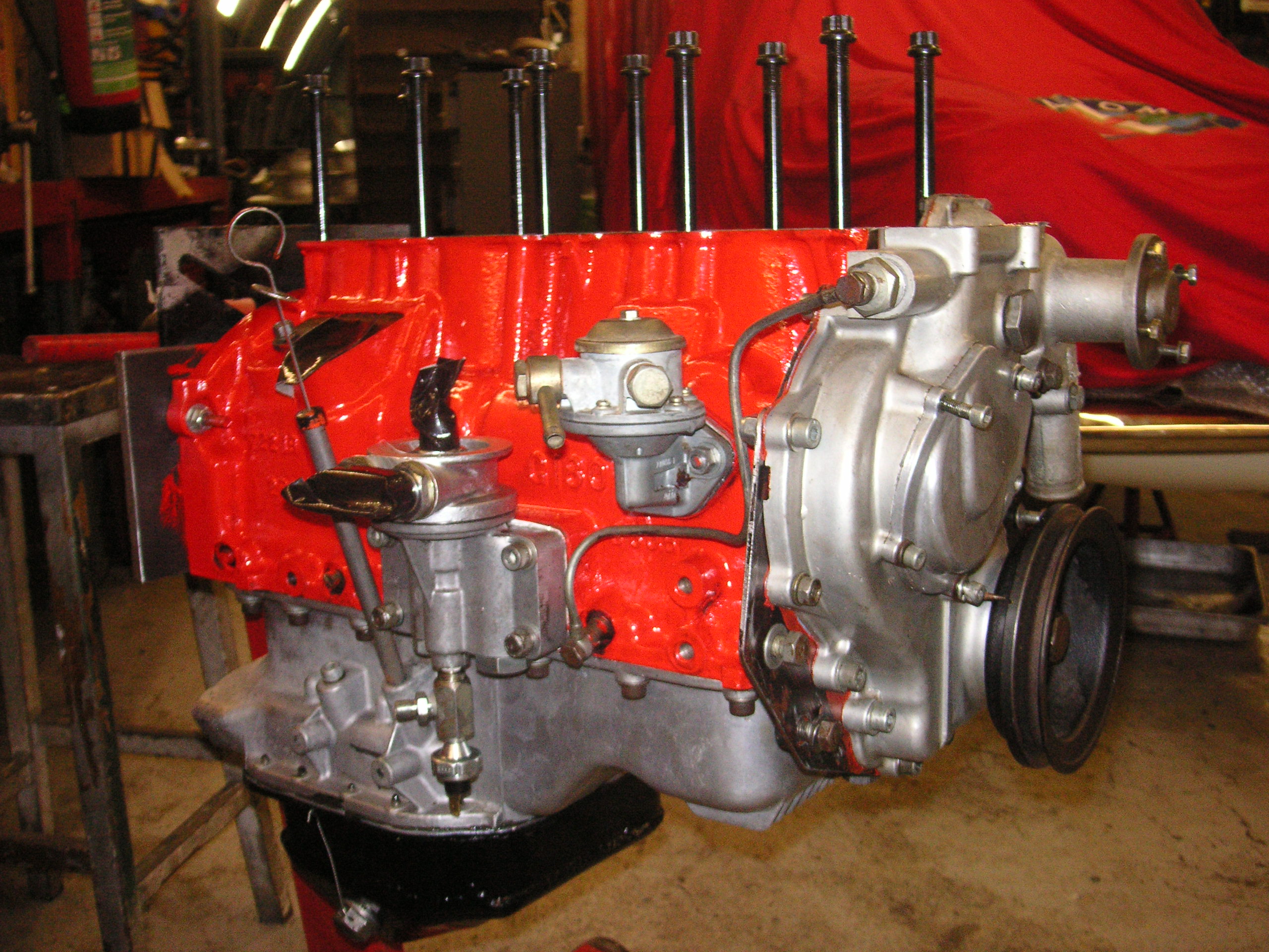

OK Rolie fans...the block is back, the crank, flywheel and clutch are balanced.
And we've splashed Sticky's favourite 'go faster' super quick paint all over the place.

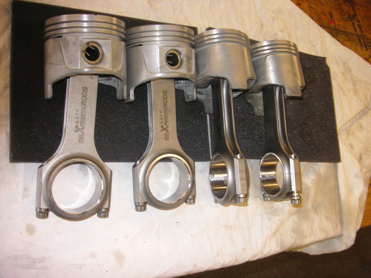

My 'aero' spec rods don't match the gudgeon pins, so there's a little extra work to be done there, but otherwise we're on schedule...........good grief, did I really just say that?!

Damn right Sticky, although if you think the paint looks quick....check out these rods.
They've even got "maXpeeding" embossed on them!
Mon Oct 09, 2017 3:00 pm
Those beauties look as though they would empty your wallet at least 2 seconds a lap quicker :P
There are only termites that have starved to death in my wallet :roll: :lol:
Mon Oct 09, 2017 9:03 pm
Hope they are 'fast' as they sure look expensive ..........

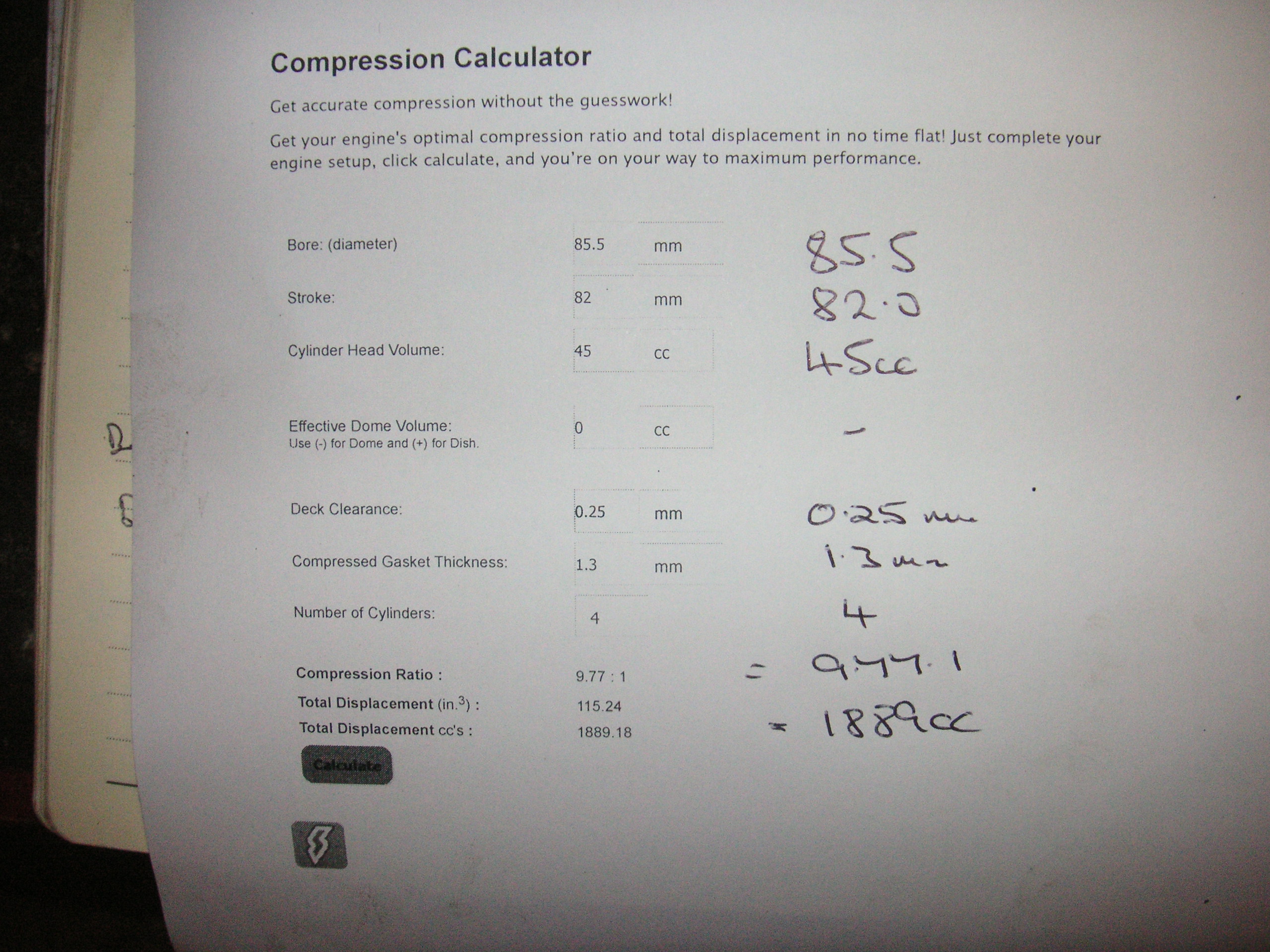

whats the calculated CR Mark
Mon Oct 30, 2017 9:36 pm
As you can see Glenn we're at 9.77...previously we were at 9.29. This will help us go a little more aggressive with the cam...but my cam folk are not sure whether the stock donor cam can handle such a re-grind, we should find out in the next few days.

Thanks for the info. I thought it maybe a bit on the low side with the flat top pistons. Not that i am any expert.
Have seen GM cams here built up with weld (some special stuff, not sure what) then they re grind them. Used a one make racing engine a while back. I imagine this is pretty costly as the cam would probably have to be straightened again etc etc.
Tue Oct 31, 2017 9:27 pm
http://www.csgnetwork.com/compcalc.html
Mark, just curious, this calc gives 9.52:1 ?
Wed Nov 01, 2017 8:35 am
Ha. It appears the figure you end up with depends on who's calculator you use....the only difference I can see between the two is that yours has a column for 'head gasket bore diameter'
Fortunately we're only really concerned with how we compare with our last engine build, so we're safe as long as we always use the same calculator.

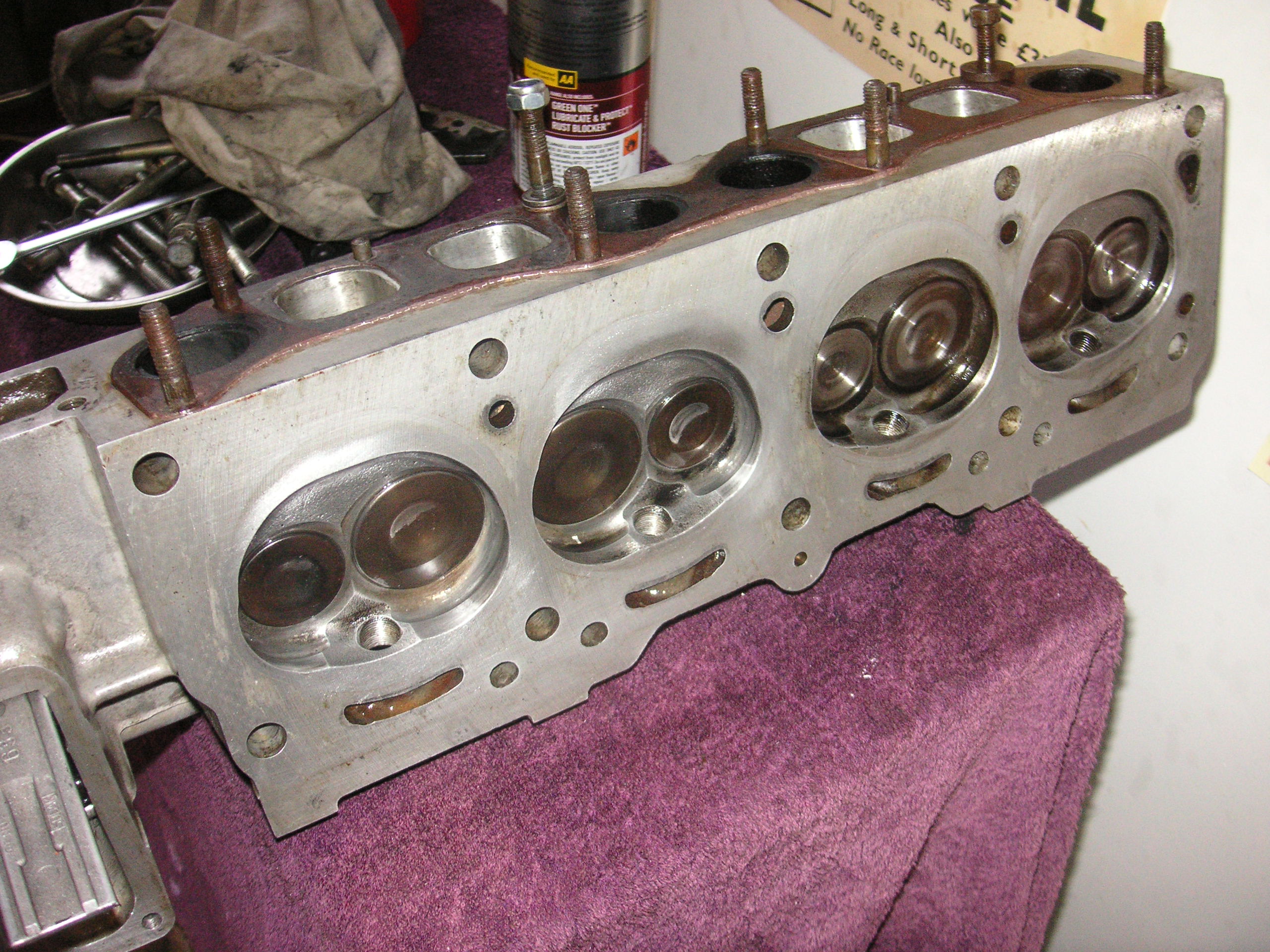

The motor's pretty much done now...here's the business end before it goes on.
Torqued down.
