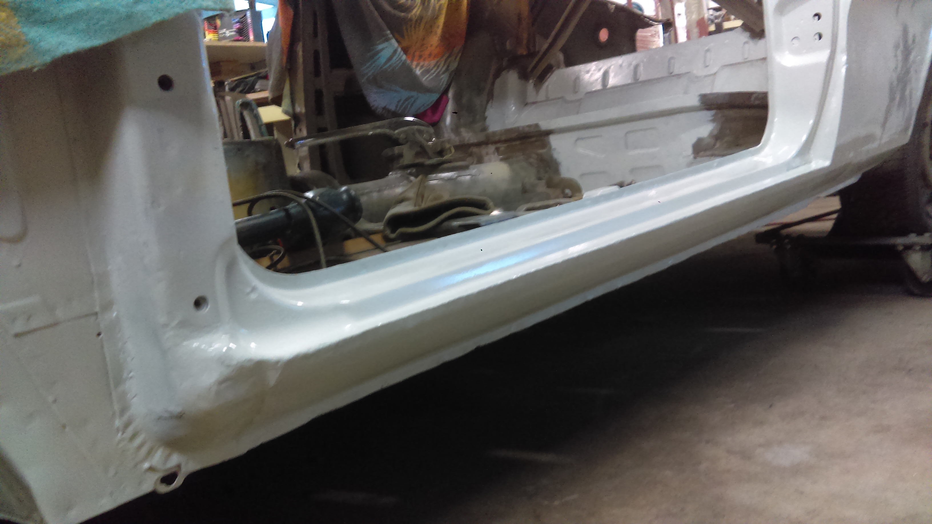

New sill welded and coated today, rear quarter coated. Will spend next 2 weeks finishing cleaning boot metal and interior floor metal before rest of rear end gets welded on.
