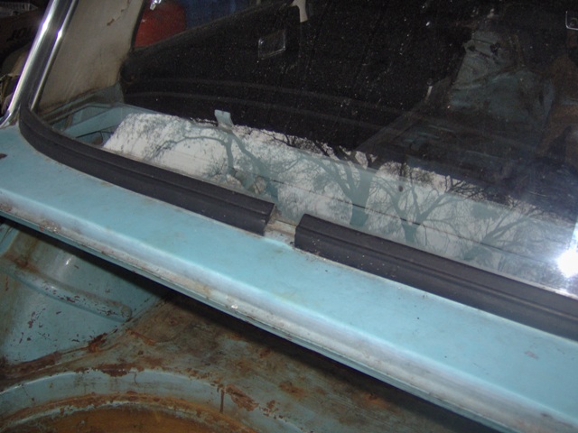

Hi
Ive noticed this condition on other sedan rear seals posted here,does anyone knows how this happens?
Mark

Sat Apr 03, 2010 3:38 am
yep. common as mud, mark.
is due to that point being the wher Isuzu glued the join in the rubber, and over 40 years of heat/cool/heat/cool since, they shrink.
the first place they "split" due to this shrinkage is that join.
without getting hold of either a brand new one, or one that is used but not split (and who knows if that one will stay joined anyway............?), the neatest way i've seen of fixing it is to cut a piece off another split rubber, and use it as a "fill" piece.
if the cuts on this piece are neat, and you use some black sealant, the join is almost invisible.
hope this helps.
