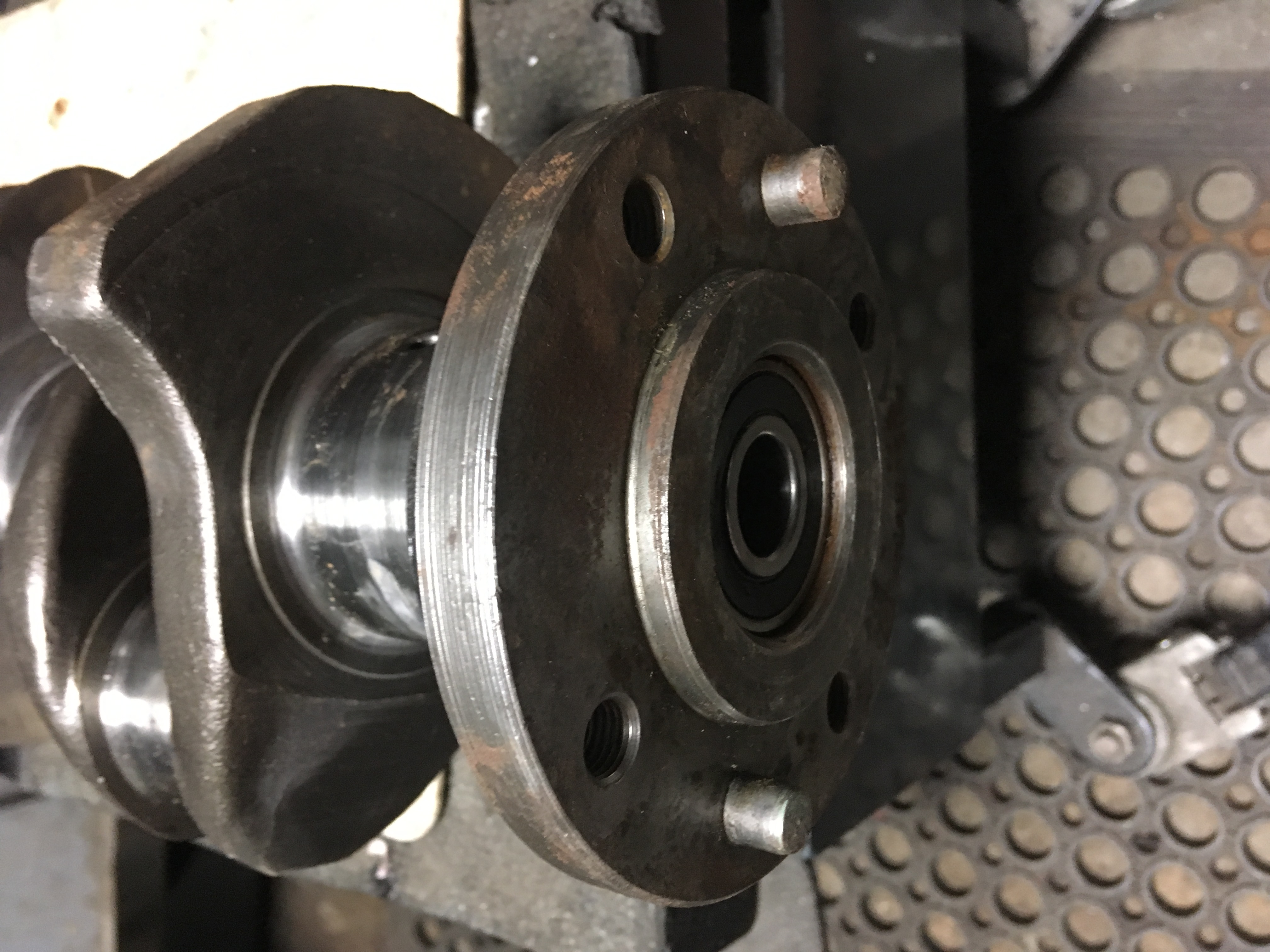

Hi everyone...just to keep you updated...the new engine build has ground to a halt.
We were progressing nicely until we discovered the donor engine (the second G180 from the States) has a bent crank.
Although I have a good crank in the current engine (the first G180 from the States) I really don't want to butcher yet another engine, just for one component.
Can you help guys?
Does anyone have a spare under their bench or know of anyone who might?
Much appreciated, in anticipation.

There is a slight possibility that the crankshaft in all vehicles that are 5 bearing is the same as yours. I'll explain.
According to my parts catalogues all 5 bearing engines built after 1967 are the same part number. G130/150/161/161SS.
Bellett sedan, GT, KB LUV Aus., Florian OHV and OHC.
These are engines with the 1/2 moon rope seal rear main. NOT full circle as in g161/180/200Z and in series 2,3,4. LUV USA.
The only listing that I have for Chev LUV USA series 1 is the GM part number 94020363. No Isuzu part number.
For Aus. and other countries it is 12310 297 Isuzu. 94021848 GM.
Have you still got the spare engine that came over with Rollie? Is it a 5 bearing.? A quick way to identify that is to look at the sump and if it is a 2 piece with the upper being alloy and has a lower sump that is pressed steel. Similar to Rollies' Engine before the upgrade. The only difference could be the clutch pilot bearing may be smaller 'OD' than the original. As far as I'm aware all transmission input shafts diameter are the same. And all the bigends and mains are the same.

Thanks for that Dave, great intel......but it's the stroke that's giving us problems.
The G180 has an 82mm stroke, and the earlier G motors either had 73mm or 75mm. I'm on to the Chevy LUV forum....but no joy yet.
Tue Jul 02, 2019 2:59 pm
Yes. Your correct. 75mm stroke. Was not thinking of top end at all. Only bottom. DRRRRRRR. :oops:
Good luck with the forum.

Hi
Just a thought - some of the g180's like mine (g180w) have 6 bolts connecting the flywheel.
Cheers Flying

Throwing out a dumb question: would a crank from a G180W work for you?
Thu Jul 04, 2019 9:46 pm
Not dumb Dean...because it's not far off, stroke's right but the gubbins either end of the crank are different.
Fri Jul 05, 2019 11:31 am
Yeah, you're right Flying.....from what I can gather, in terms of 1800 Chevrolet LUVs, from 72-75 the series 1-4 all had the four bolt crank, the later ones had the six bolt job with a different nose.
The lack of a straight crankshaft is now becoming a serious nuisance, I might have to have one made, but at the moment they're quoting 6+ months, which inevitably will take us well into next season.
Go on, have another look under the bench, there might be one under there that you've forgotten about!!!
