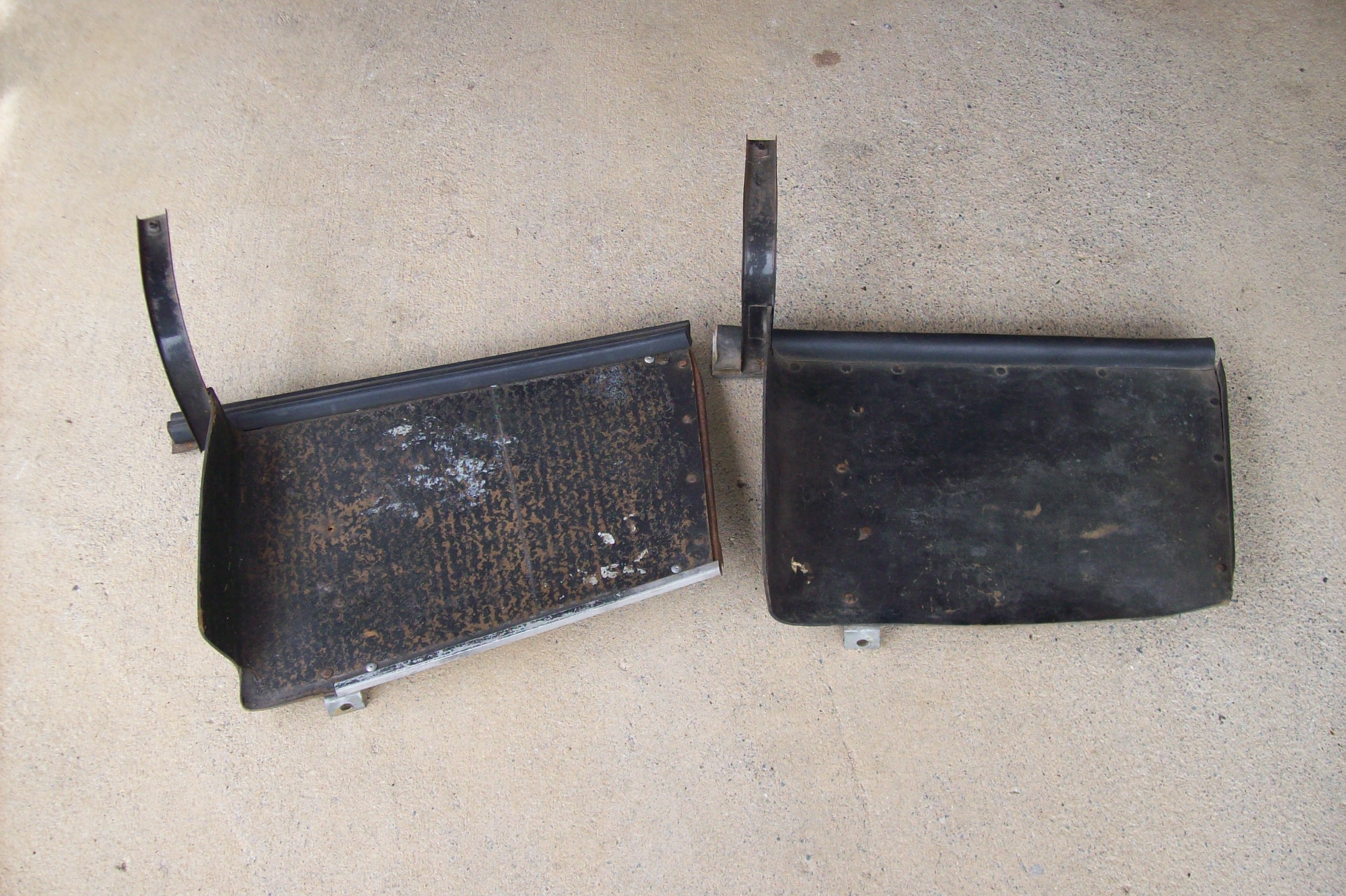

My 72 sport has one. Obviously not Aust delivered though but i thought at least all GT's had them standard.
Mounts: as far as i recall all Belletts have a tapped hole on the A pillar....... one bracket goes in there (pics)
On the right, a curved bracket runs up under the lower dash area.
At the back there are L shaped brackets underneath that screw into the firewall. Possibly those holes are in all cars too, not sure.

Every PR91 GT that was Aust delivered had one. Guaranteed.
Never seen one in a sedan, even a Deluxe. Doesn't mean pre 69 cars didn't have them tho. I've just never looked
Can also guarantee that 69 Deluxes did not have them tho.

I've attached a few pics of the Parcel trays out of my GT's.
Hoping those who are not aware of what We are discussing will now know.
Even that I had a sample to copy from I reckon would still be easy to make.
