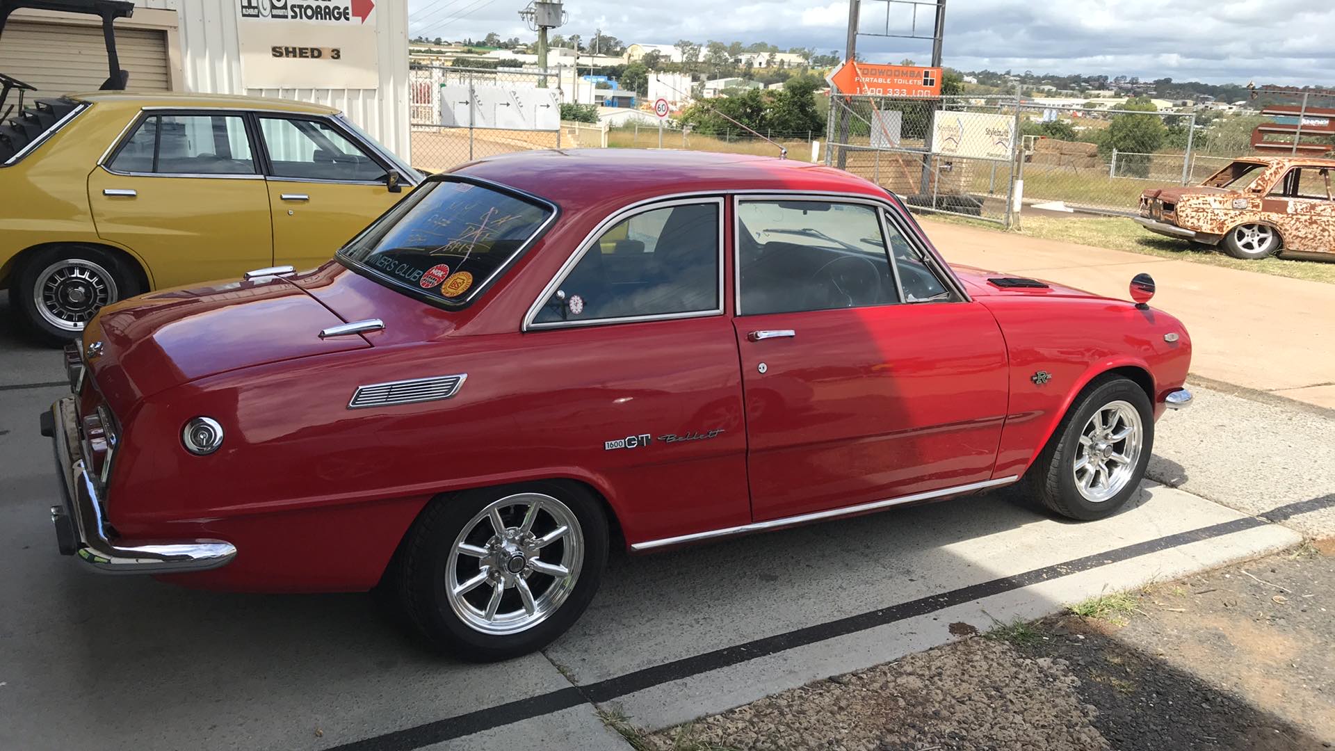

I bought a Bellett GT-R in Japan last year and it currently undergoing a full bare metal resto in Australia, with an estimated finish date of November 2020. I was in Japan in Jan/Feb this year and caught up with Norikuni Okazaki ( owner of a blue modified GT) and Akira Ogawa. Akira san worked his whole life at Isuzu, mostly as a mechanic and related fields. He has just retired and is the owner of an orange GT-R. I had him inspect my Bellett at Yokohama to verify its authenticity. He gave me a copy of a September 1969 Isuzu Company internal Bulletin.

Interesting document on the GTR. I have a 72 Sport Bellett and it shares the bigger fuel tank with the GTR. And the bonnet vents. Not sure if that tank was a retrofit or standard on this year. I wonder what the strengthened chassis mods were? Even though a late model my steering column does not seem to be a collapsible type. Was that only on GTR?
I'm sure all of would love to see some pictures of the car before and during the resto if you would like to share.

I will post a few pre resto pics but not being used to the mechanics of this forum yet, see how we go
Regards
Peter
91429694_1057904004589768_1238585293045497856_n.jpg [ 218.35 KiB | Viewed 21669 times ]
Tue Sep 15, 2020 7:08 am
Thats one nice looking GTR you have.
Resto pictures will be very nice to see, but it looks so nice now, are there some hidden issues?
Late models had some braces up under the dash area on the A pillars. I assume that's part of what the GTR has. They angle back from the firewall to the leading edge of the doors.
