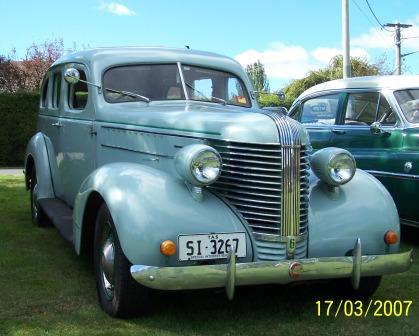

Hi Texas
I found a photo of our 1938 Pontiac van. Imported new as a cab chassis from USA by my grandfather and had a "Holdens" body made for it in Australia. It left the family in the late 40s and came back for a badly needed resto in the late 60s early 70s.
It is a sidevalve 6 with the very good steering and brakes that were the hallmark of Pontiacs of the era. The shockers have been upgraded and a panhard rod on the rear makes it behave a bit better than the original design.
